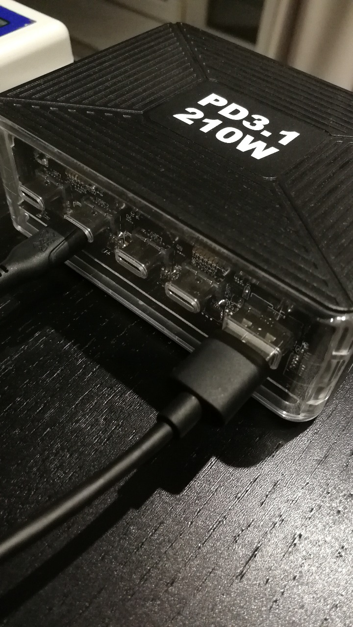

I'm using the PD3. 1 power source, see the photo. This one works well with TS101 and MHP50 (black Miniware cable, 20V, 5A). However, my new MDP-P906 behaves strangely. Sometimes, it inputs as 20V/5A, but most often as 5V/3A. If I call the menu then the device set 12V/3A. Sometimes, if the current mode 20V/5A, then the device autoshitdown, after that 5V/3A. Also, it doesn't save the setting, max input current as 5A (after restart 3A). I recorded the video. Link https://cloud.mail.ru/public/Xe4R/CwkSPbSJZ
