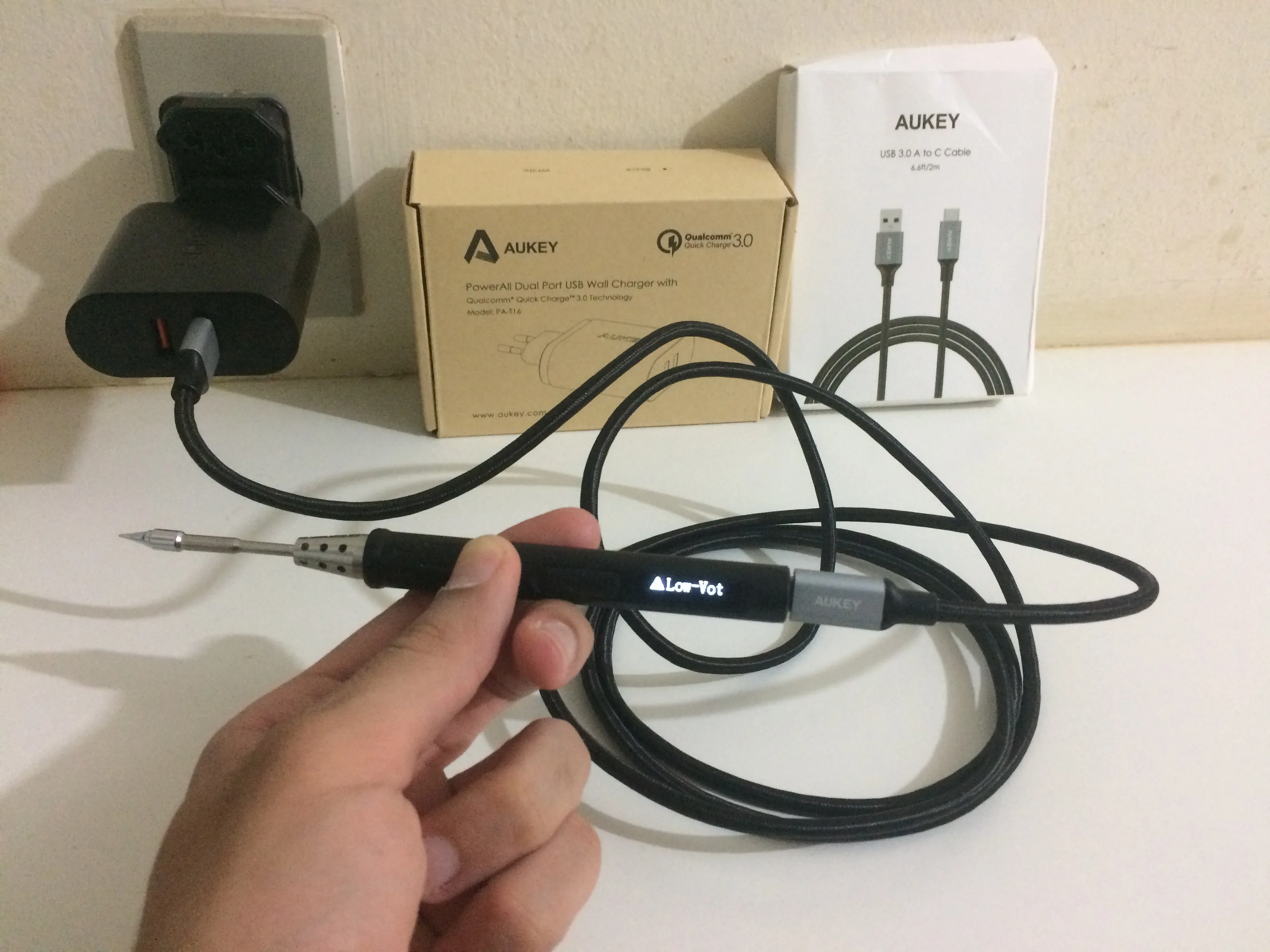

Hello guys!
My TS80 does not work.
It turns on, but the screen is written "Low-Volt". He does not get hot.
I use charger and quality cable. The two of the brand "Aukey 3.0 Quick-Charge".
I want to know what can be done, because the Ts80 does not work.
Can someone help me ??

发表于 2018-9-1 18:11:48 | 显示全部楼层
JeanCFF Posted 2018-8-31 10:05
Hello guys!
[SOLVED]
I put the power at 16W and the TS80 now works.

 楼主| 发表于 2018-9-3 09:33:01 | 显示全部楼层
Maybe the power supply output is only 16W

发表于 2018-9-3 09:41:58 | 显示全部楼层
minidso Posted 2018-9-3 09:33
The manual says 19.5W, but it has two USB outputs, I suspect that might be it. Maybe it can not guarantee the 18W for TS80.

 楼主| 发表于 2018-9-3 14:53:22 | 显示全部楼层
It may be compatibility. Try to adjust the power.

发表于 2018-9-4 14:18:29 | 显示全部楼层
Have the same issue with all Blitzwof chargers and power banks I have. All comaptible QC3.0/2.0 and state to have 9v 2A.
It is possibel to make TS80 working by setting 16W but it works not always sometimes only once just after the settings change.
Also here is another problem temperature  do not stabilise it changesfrom 100 to 400C or above in some cases, mainly from 200 to 350. Check the video.

发表于 2018-9-4 20:55:05 | 显示全部楼层
I have Baseus Powerful Portable QC 3.0 20000mAh Power Bank. The instruction is "If no connection, the power is automatically in a dormant state after 20 seconds."
In fact, during operation when the tip is not heated, the power supply is switched off.
Is there a chance that it will be somehow corrected in the new version of the firmware?

 楼主| 发表于 2018-9-5 09:34:38 | 显示全部楼层
This is because your power band does not support small current power supply.
When the TS80 is at constant temperature, the power is very low, if the mobile power does not support small current charging, then it will be considered that there is no external equipment.
